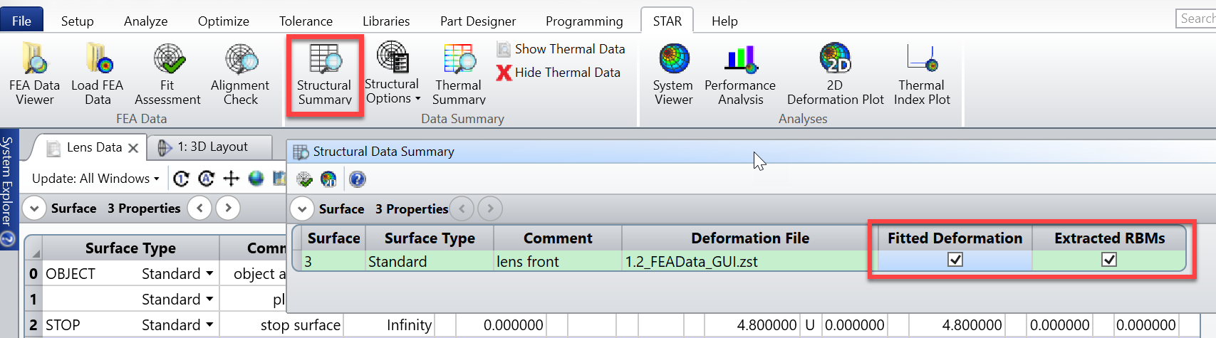

Under the STAR...Structural Data Summary, it lists which surface has structural data loaded and what data file is being used. Checking or unchecking the Status boxes will enable or disable the different structural data components on a given surface. User can make the following four selections, RBM only, Surface deformation only, Both RBM and surface deformation, or None. When the structural deformation is first loaded into your system, STAR performs an initial fitting to calculate the amount of rigid body motions, shifts and tilts, for a given surface so the structural deformation can be separated into two groups. By using the check box in Structural Data Summary one can choose which structural effect to enable.

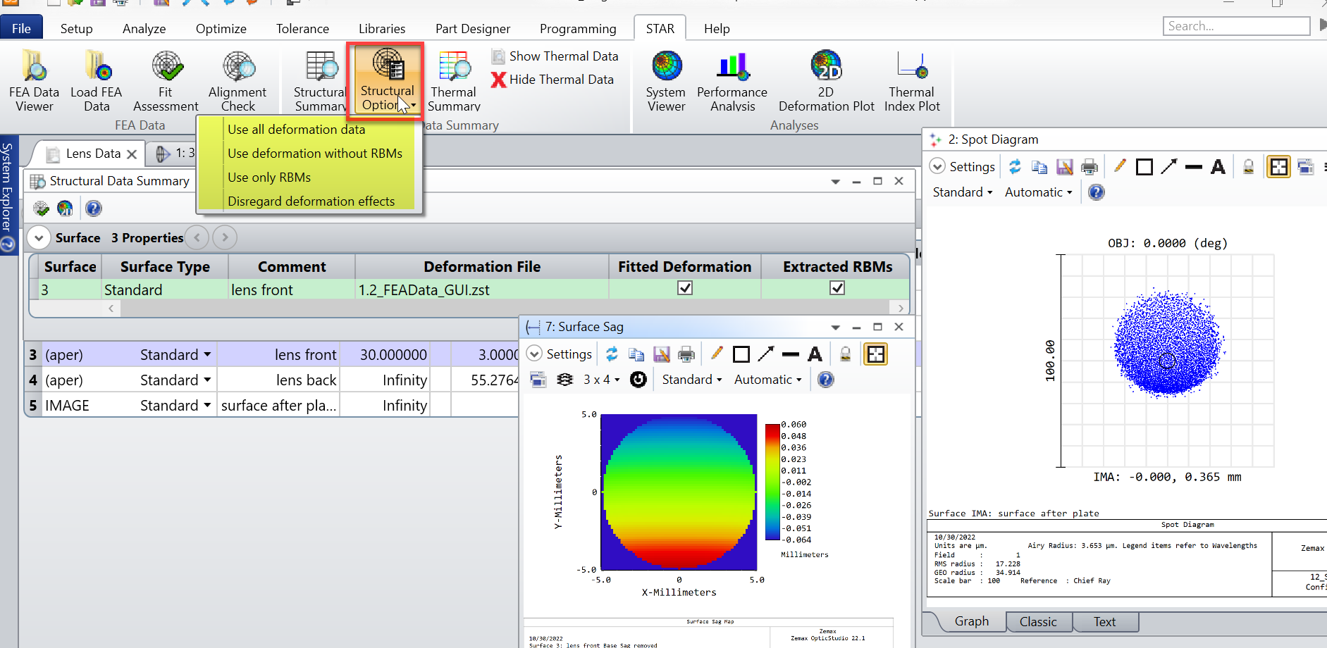

Alternatively, you could also do so via the added Structural Options menu. Clicking the button will drop down a list for you to make selections of Use all deformation data, Use Deformation without RBMS, Use only RBMs, or Disregard deformation effects. Selections made via the Structural Options menu will reflect itself in the Structural Data Summary editor and will have an impact on ray trace results depending on which part of the structural deformation data is turned on.

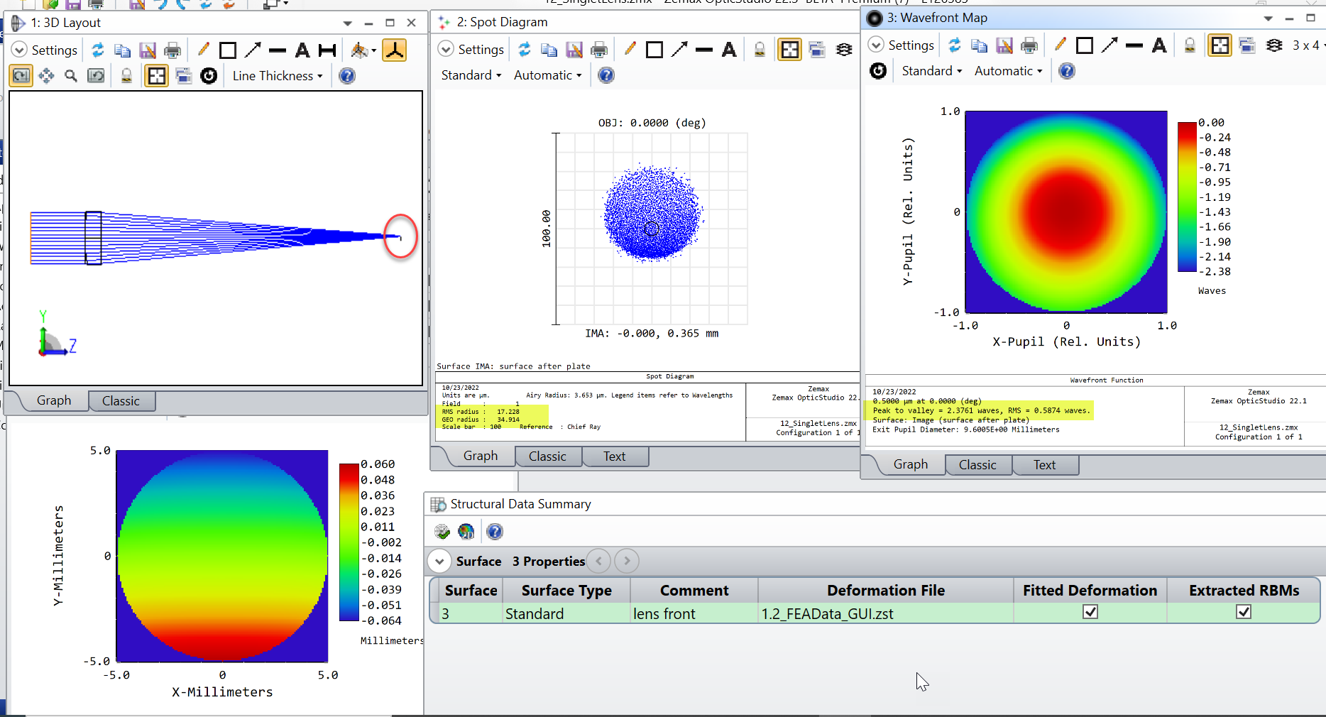

In this section we’ll demonstrate how this Active RBMs feature works using an example. The demo system is a singlet lens focusing an incoming collimated beam. In the nominal system, after optimization the RMS spot radius is 6.2 um, which is on the same order of the Airy radius of 3.6 um. The RMS wavefront error is 0.19 waves. The performance is close to diffraction limited. The spot is centered on the image surface vertex. Below we show the 3D Layout, the Spot Diagram and the Wavefront Map of the nominal system.

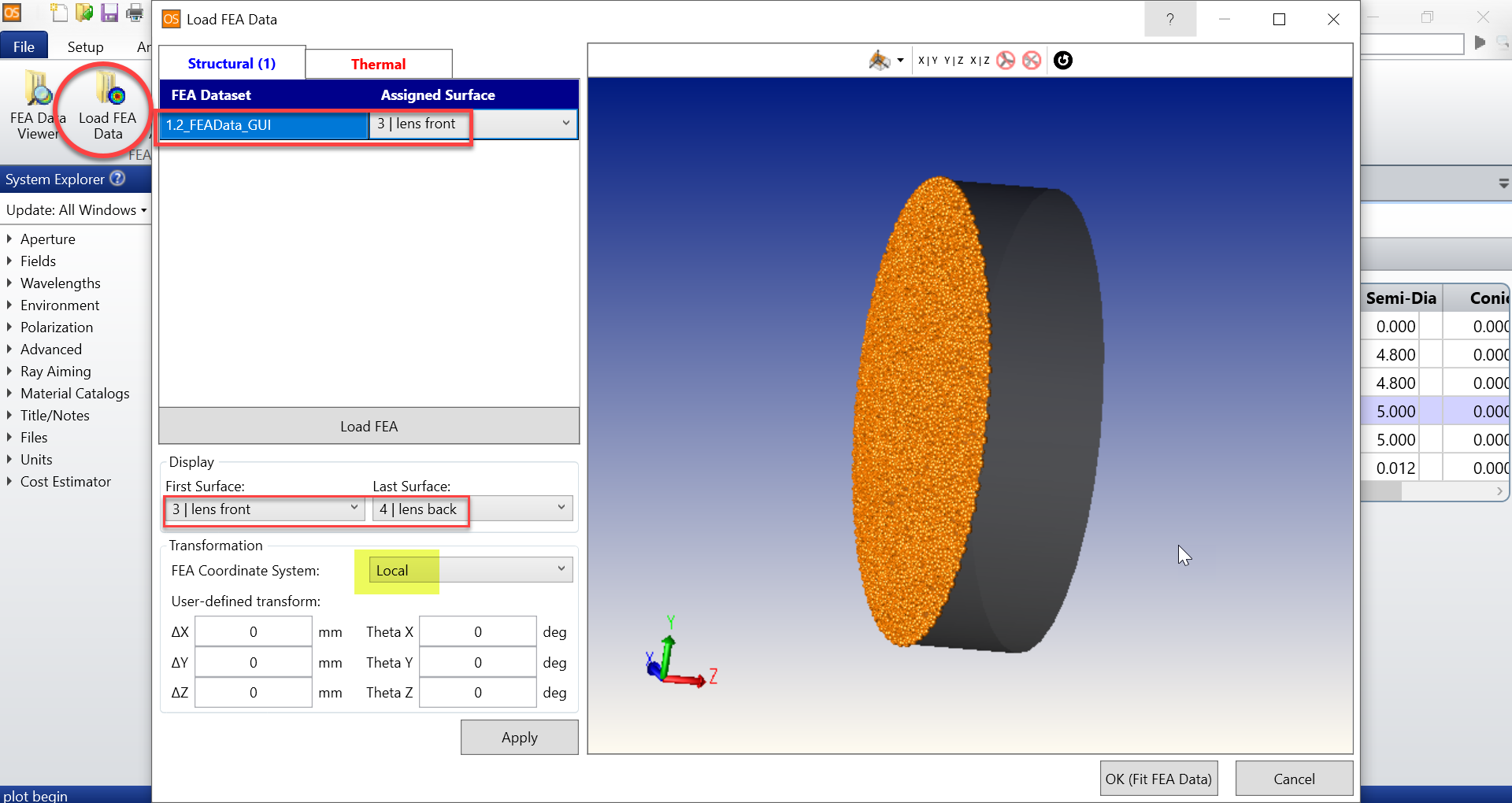

Next let’s apply one set of structural deformation data on the front of the singlet lens using the Load FEA Data tool. This artificial dataset is created to introduce a small tilt motion to the front face of the singlet to simulate wedging effect, as well as additional surface curvature to deform the front spherical surface to aspheric shape. In other words, this structural deformation dataset consists of both rigid-body motion and higher-order surface deformation.

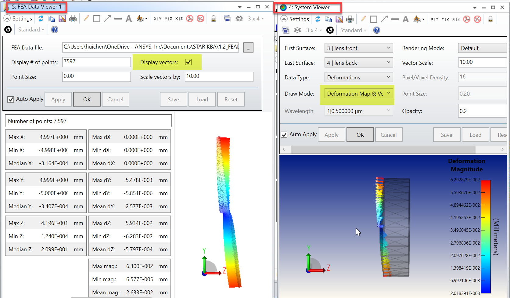

There are two tools you can use to examine and visualize the deformation introduced by the structural dataset. One is the FEA Data Viewer and the other is the System Viewer. You can find both tools under the STAR tab. The FEA Data Viewer enables users to view the FEA dataset without assigning to an optical surface in the system. This allows the opportunity to verify the correct file before assigning to an optical surface and performing a numeric fit. The viewer also displays pertinent information about the FEA dataset such as the number of data points, Median, Max/Min of positional information, and Median, Max/Min of deformation and temperature data. The System Viewer displays a system-wide view of the deformations and changes in optical properties due to the fitted FEA data. This data is overlaid on the entire optical system in a single window. In the screenshot below I enabled vector display in both analyses and assigned a scale factor of 10 to enlarge the displayed vectors for easy viewing in the layout window. Surface deformation can be represented using deformation vector which shows the magnitude and direction of the deformation. In the plot below the deformation vector arrows indicate a clear tilt motion about the X axis of the front surface.
In addition to these two analyses, you can also use Surface Sag analysis to display the sag of the deformed front surface of this singlet. If you open the Surface Sag analysis and choose to Remove Base Sag which removes the nominal sag of the underlying surface, you will be able to view the deformed sag introduced by STAR FEA dataset.

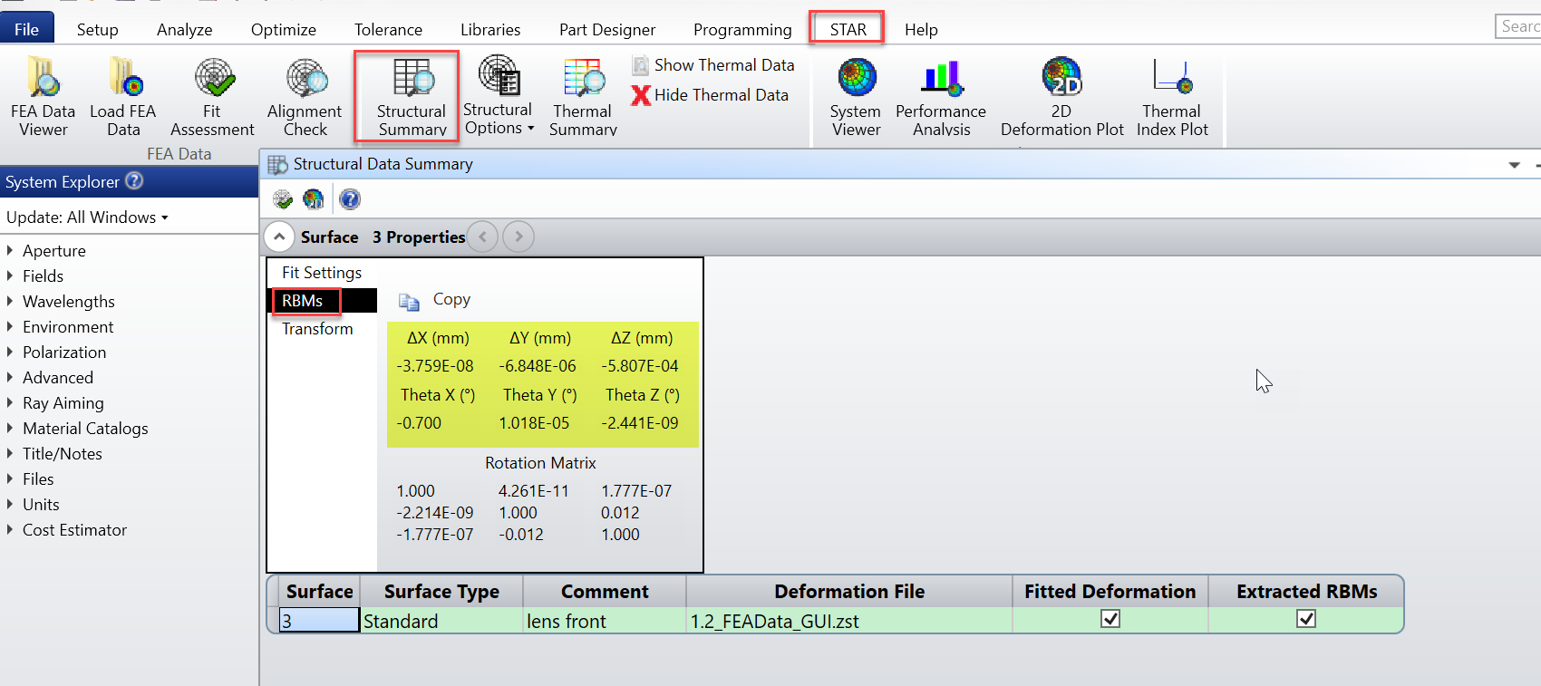

When the structural deformation dataset is first loaded onto the surface using Load FEA Data tool, the added deformation contains both rigid-body motions as well as higher-order surface deformation. STAR performs fitting internally to compute the amount of rigid-body motions, ΔX, ΔY, ΔZ, Theta X, Thera Y, Thera Z. You can find this RBM information reported in the Structural Data Summary under the Surface Properties\RBMs tab.
Now let’s take a look at the ray trace results. The first thing noticeable is that after the deformation data is loaded onto the front surface of the lens, the spot is shifted upward and no longer centered on the image surface vertex. This can be seen both in 3D Layout and the Spot Diagram. We’ll also open a Surface Sag analysis and select Remove Base Sag to view only the deformed sag on this surface 3. Here the sag plot displays a dominating surface tilt. Let’s also open the Spot Diagram and the Wavefront Map analyses to look at imaging performance. The RMS spot radius has increased to 17.2 um and the RMS wavefront error increased to 0.587 waves. These results suggest the system performance has worsened due to structural deformation and is no longer diffraction limited.

In the Structural Data Summary editor, you’ll see the last two columns labeled as “Fitted Deformation” and “Extracted RBMs”. Users have the option to separately turn on higher-order deformation or calculated RBMs. If we choose to keep only the higher-order surface deformation by unchecking the RBMs box, you can see the spot now moves back to image surface center, and the sag profile only displays a rotationally symmetric aspheric deformation. The RMS spot radius remains large at 17.3 um and the RMS wavefront error at 0.583 waves.
