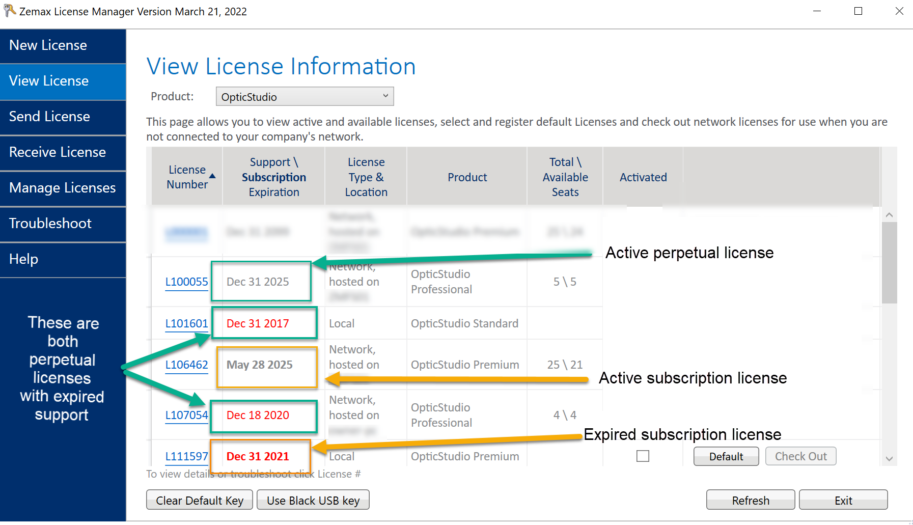

1. Open the Zemax License Manager application on any machine that you run Zemax software.
Note: License Manager versions dated before Sept 2019 will not show the bold text so cannot be used for this.
Go to the "View License" section. You can tell the difference as the subscription licenses have a bold text for the expiration date. See the example image below for examples of both license types.

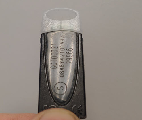

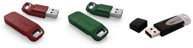

First, check all USB ports on your computer for a USB key which is about the size of a USB thumb drive. These keys must be plugged into the machine which is using them. They look like the following:
If you are using a single user Black USB key, these need to be plugged into the same machine where Opticstudio is installed. You can check the license itself, as it will have a matching 5-digit number engraved on it. For example, this license is 29966.

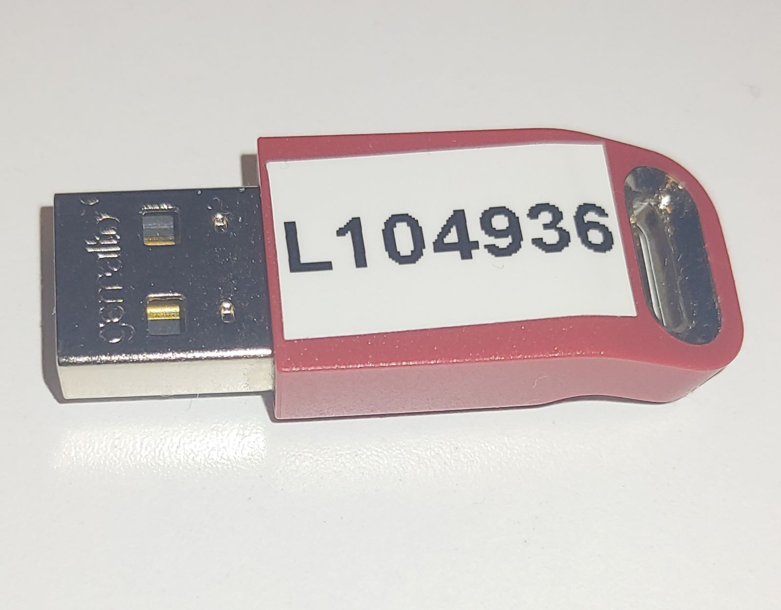

Red and Green single user licenses do not have the license number engraved directly, but Zemax places a sticker on them with the license number (such as L1XXXXX).

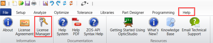

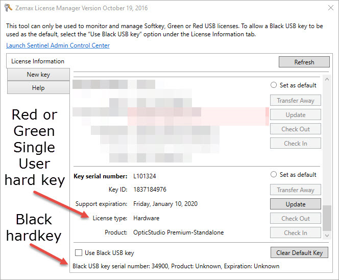

  2. To confirm the type, open Help...License Manager

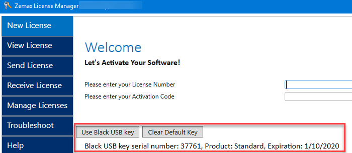

  1. In OpticStudio versions that postdate June 2019, Black USB license information is listed under the New License section.
Black USB license in June 2019 License Manager

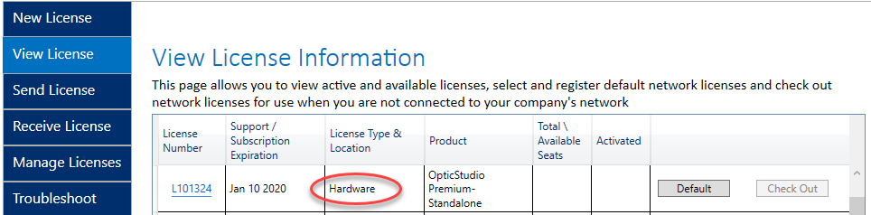

Red or Green USB license information is listed under the View License section. These are differentiated from softkey licenses with the designation License Type: Hardware.
red or green USB license
  1. In OpticStudio versions that predate June 2019, check the License Information section for Black, Red, or Green USB license information. Note the License type: Hardware, which tells you this license is plugged into this machine rather than a remote server.
Note: If you have a Red or Green USB license attached you your machine, you will find the key serial number starting with "L" that matches the number displayed in the title bar of OpticStudio. The "Product" field will contain "Standalone," and the License Type is "Hardware".

  2. If this type of string is present, confirm the license type by selecting open Help...License Manager.

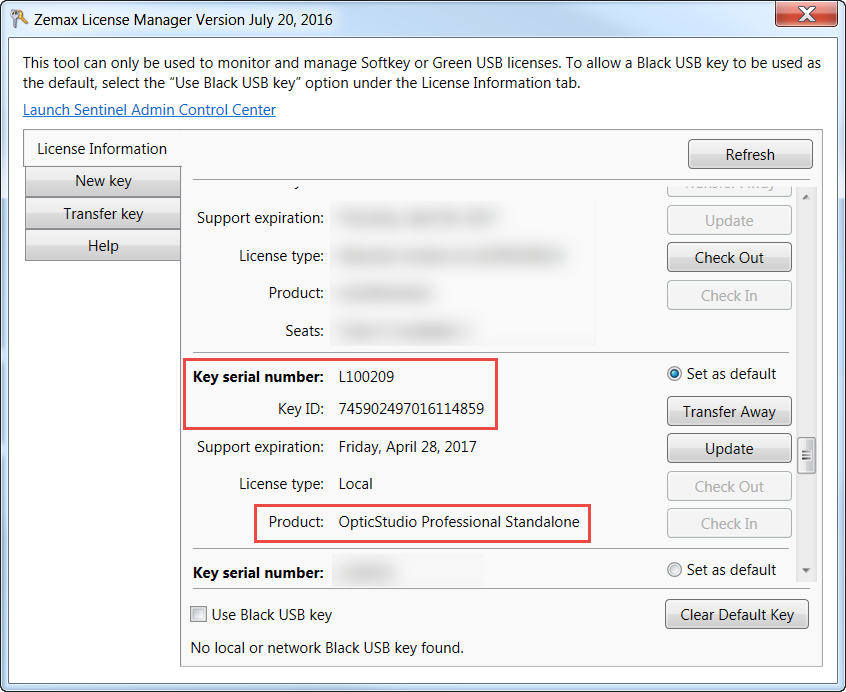

  3. Locate your license key serial number in either the License Information or View License section of the Zemax License Manager.

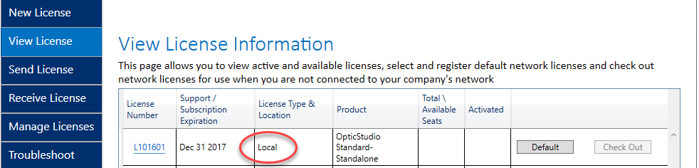

  1. Ensure that the "Product:" field reads "OpticStudio *** Standalone," where "***" indicates your software edition. The license type should read, "Local" for a softkey license, and "Hardware" for a USB license attached to the computer.
  2. Record the number listed in the "Key ID:" field.

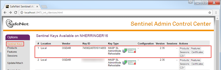

  3. Click Launch Sentinel Admin Control Center from the License Information or Troubleshoot sections. This will open the following page in your web browser.
  1. Navigate to Sentinel Keys and locate your Key ID. If the location given is "Local" and the Key Type is “HASP SL AdminMode Rehostable," you have a single user softkey license installed on your machine. If "Location" is a computer name then this is a network license hosted on another machine.

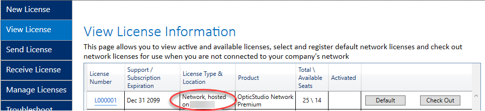

To check if you have this license, first make sure that you do not have a Green, Red or Black USB License plugged into your machine. Assuming this is true, launch OpticStudio and look at the window title bar. If you have a 5-digit number listed here, you have a Network Black USB Hardkey (this number is your key serial number).

  2. To confirm the type, open Help...License Manager.
  3. Locate your license Key serial number in the License Information or View License section.
  1. Ensure that the "Product:" field reads "OpticStudio *** Network", where "***" indicates your software edition.
  4. Navigate to Sentinel Keys and locate your Key ID.
  1. Locate your Key Type:
    1. If the Key Type is "Sentinel HL Net #", then you have a network Red USB hardkey license.
    2. If the Key Type is "HASP SL AdminMode Rehostable”, you have a network softkey license.
