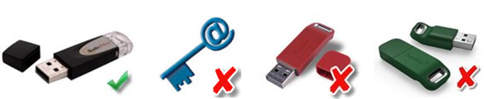

If Opticstudio requests a license code when you launch it, this details how to request one. It also covers common issues applying a license code and the software license support policy. This applies to those using Opticstudio with a black USB license key.These key types have a serial number of 22000-40999 and look like the picture below

This article applies to those who have a Black USB license plugged into the machine with Opticstudio, or are connected to a network license server with this key type. These key types have a serial number of 22000-40999 and look like the picture below

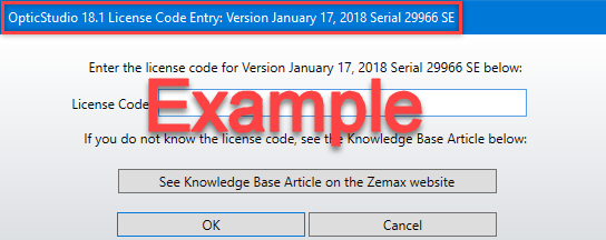

The first time you run OpticStudio, you may be prompted for a license code as shown here.
If you see this dialog box, your copy of OpticStudio is correctly installed and the license key is recognized by the software. You just need a license code to allow this version of OpticStudio to run with your key. To request a license code:
  1. Take a screenshot of this dialog box on your screen (not the above example image), using Alt-Print_Screen, Windows Snipping Tool, or any other screen capture software. If you are unable to provide a screenshot, you may send in the first line of the license code request box instead. See the section highlighted in red in the example screenshot.
  2. Open an Ansys support ticket from https://customer.ansys.com . Include the screenshot or requested version and key number from step 1 . One of our global tech support staff will reply during support hours (currently 24 hours a day, 5 days a week). If your license is not eligible for the release you installed or there is any other issue, they will inform you of your options.
  3. Once you receive the license code from Zemax, enter it into the license code box and click Ok. Opticstudio should start up. If you have any troubles after entering the code, check the FAQ’s below.

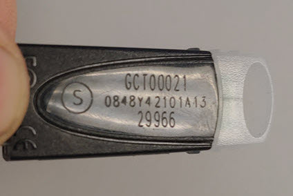

First, verify you are using a Zemax license and not one for other software. All Zemax Black USB licenses will have the license number engraved on them. For example, this license is 29966.
Next, see if the USB driver is working. Black USB licenses light up with a green light when plugged into your machine. If it it does not light up, first try restarting the machine. If that doesn't work, check the article Troubleshooting license issues with a Black USB license.
