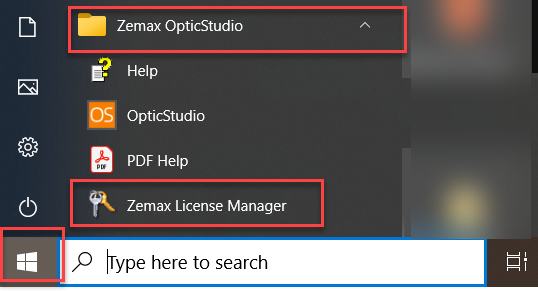

  3. Open the Zemax License Manager on the licensed machine, normally located in the Windows Start menu under either the Zemax OpticStudio or Zemax License Manager folder.

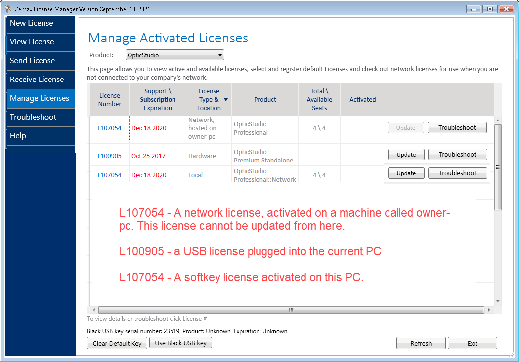

  4. Locate the license number that you received an update code for. Make sure the "Update" button is not grayed out, and move to step 5.
    If "Update" is grayed out or if the license is not listed: This means you are not logged into the machine where the license is installed. This most often happens with a network license when you are not logged into the machine where the license is activated. Forward the update email and .v2c file to someone with access to the server listed under "hosted on" in the "License type" column to apply the update.

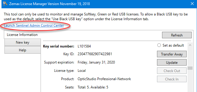

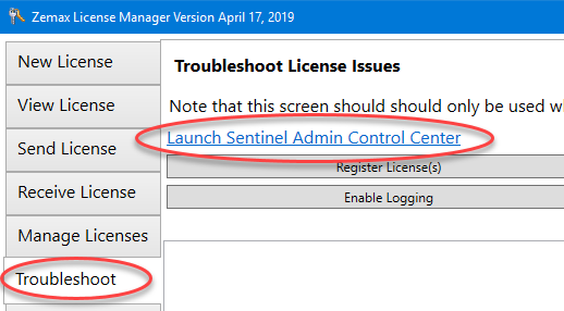

  5. Click Launch Sentinel Admin Control Center located on the Troubleshoot tab or at the top of the Zemax License Manager.

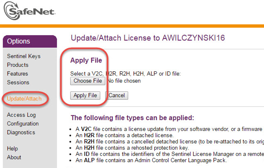

  1. Click on Update/Attach in the left-hand Options column. Click Choose File and locate the .v2c file you saved. Click Apply File, and you should get a short message saying the update was applied. If you receive any errors, see the Getting Help section below.
    Note: You may delete the .v2c file we send you after following this procedure as it cannot be reused.
