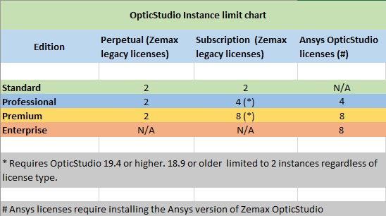

Each license has a limit for how many simultaneous OpticStudio instances may be opened at one time, and the limit is determined by the type of license you own. This section clarifies the limits for each license type and version of the software.
For all OpticStudio 18.9 and lower releases, only 2 instances per machine are allowed. This limit was built into the software. When OpticStudio 19.4 came out, we released a new subscription license type. These license types have some new OpticStudio features, including additional instances for Professional and Premium.
For those customers who have perpetual legacy licenses and 19.4 or higher, the limit remains at 2 instances for all editions of OpticStudio.
For Ansys licenses, both perpetual and leased (subscription) the limits are similar to the subscription legacy licenses.
See the chart below for a full breakdown:
If you are interested in converting a perpetual license to a subscription or Ansys license, contact your Zemax account manager or the sales team.

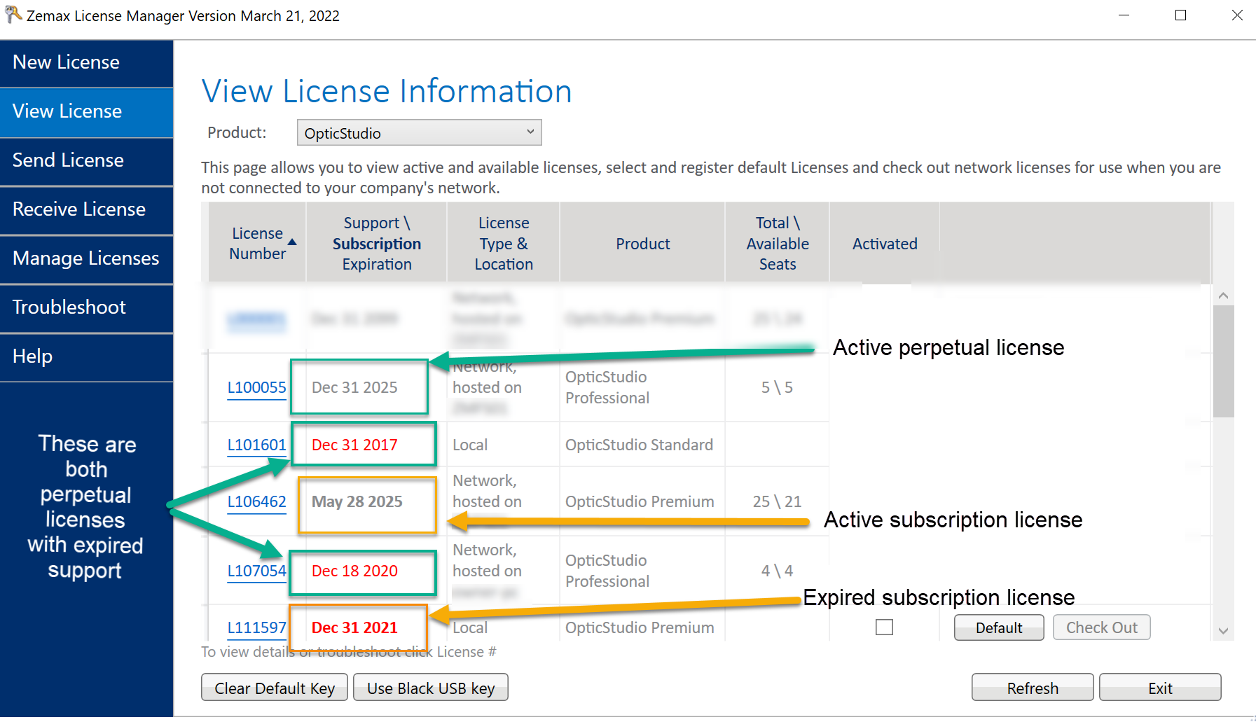

The number of OpticStudio instances you may have running at one time is determined by the maximum number of instances your license is eligible for. You can find additional information on identifying your license type in this article. A screenshot from that article is provided below:
NOTE: This section only applies if you have a legacy Zemax license (license numbers starting with L or T, or a 5 digit number such as 22000).
If you have OpticStudio 19.4 or higher, you can also check the “View License” page in the Zemax License Manager. Subscription licenses will show the license expiration date in bold text. Note: this information is not provided for releases older than OpticStudio 19.4, as they came out before subscription licenses were offered.
You can also test by trying to open OpticStudio windows. If you have OpticStudio Professional or Premium, are using version 19.4 or higher, and you can open more than 2 instances, you know you have a subscription license.
