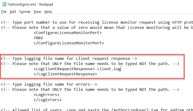

2. Open the file sntlconfigsrvr.xml in Notepad. There are two log files you can create, one to log errors, and the other to log usage. We want this second one. Edit the LogClientRequestResponse section as follows:
and re-save the file.

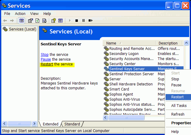

3. In Control Panel...Administrative Tools...Services, restart the Sentinel Keyserver service:
services

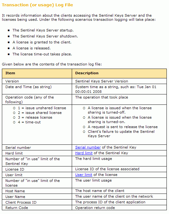

4. The file client.log will now be created in the same folder as (1) above. The format of the log file is as follows:
transaction (or usage) log file
