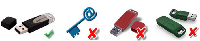

This article applies to those who have a Black USB license plugged into the machine with Opticstudio, or are connected to a network license server with this key type. These key types have a serial number of 22000-40999.

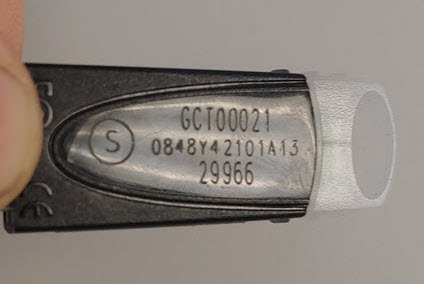

If you have a black USB license plugged into your machine and get left at the "New key" page, then the software does not recognize your USB license. First, verify you are using a Zemax license and not one for other software. All Zemax Black USB licenses will have the license number engraved on them. For example, this license is 29966.
